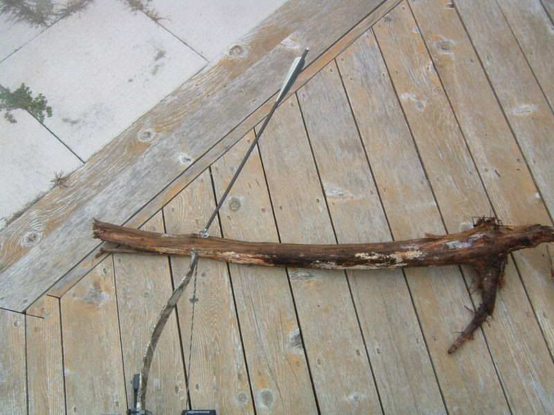

IS IT BENT???
[img]http://i463.photobucket.com/albums/qq352/1garywindom/bones.jpg[/img]
