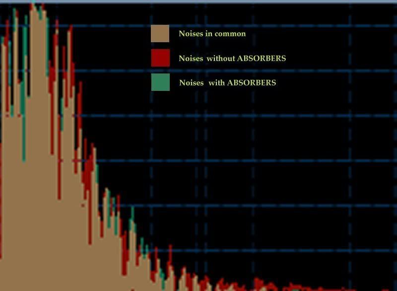

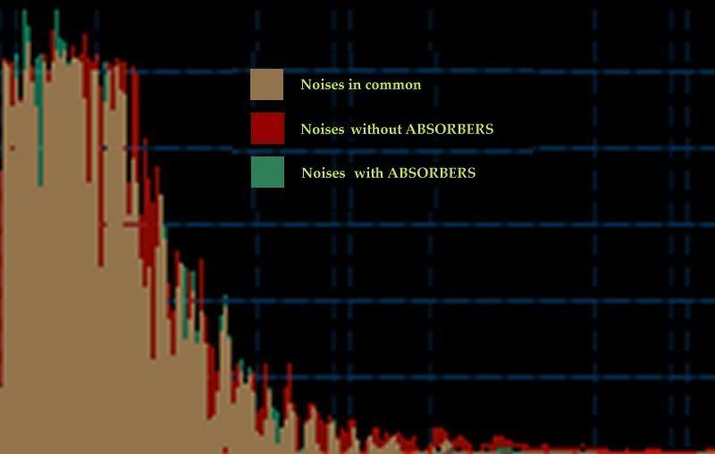

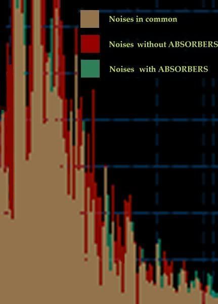

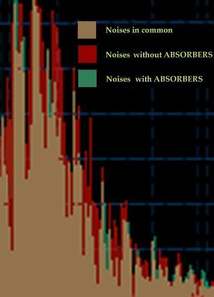

I have done some test with an audio analyser, to test my Crossbow Absorbers; I used a 393 grs arrow and Exocet 200 crossbow.
With Absorber System the speed is 324.6 fps, without is 321.0 fps
In brown the noises in common.
In red the major noises without Absorber system.
In green the major noises with Absorber system.
I have done 4 tests to be sure of results, and this is the result:
I have got an important noises decreasing and in the same time I have got 3.6 fps more.

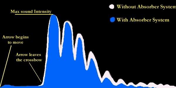

Ok, on the vertical scale (Y axis) you can find the Total Sound Intensity (all the frequencies) and the horizontal scale (X axis) you can find the Time. So this graphic is the exact sound image of one crossbow shoot. With the graphic you can see a noticeable noises decreasing during the fist part of the shooting,(normally the phase of maximum string stress),
and after the Absorbers disipates also the sound quicker (has a shorter duration).
Do you know the terrible "metallic" sound that the crossbow does using light weight arrows?
This Absorbers kills complitely the "metallic" (I apologize all high frequencies) sound, the sound becames soft and shorter, the same sensation if you use not a 393 grs arrow but a 550 grains.

The graphic shown is a "compact" graphic where you can see the complite
sound image, but is not so detailed. I have much more detailed graphics, where you can see perfectly the noise when the arrow is in move.
Now I'm in office and I don't have this material with me, but I can show you with a paint, the "real" sound graphic:
The first part is when the arrow is in move on the crossbow riser. No diffrences with/without Absorbers. The Brace H. with absorbers is 0.8" shorter, so the first big noises, caused by string extensions, arrive a little after.
The total noises intensity on the first string exstension are the same: I think the only way to drecrease them is: 1. one heavier arrow weight. 2. A crossbow with less poundage 3. A string more elastic..
After this point the Absorbers begin to work, and they suppress the energy of second and succesive extensions always better, decreasing maximum sound intensity and total sound duration.
I don't know in the grafic where are the high frequency noises, but sure the "metallic" sound (it seems to be an high frequency sound) with Absorbers now is killed.
