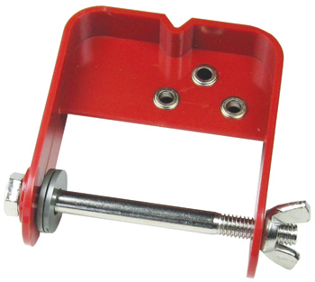

I've watched that video before. That method may work well on a string for a traditional longbow (or recurve) where the serving (on a much longer string) is held by fingers for a release, but I doubt if it would work for a compound or a crossbow where the string is held by a release or claws. The angle is much more acute, and the tension is applied to a very small area on those strings.
For a crossbow string you need a good bit of tension when wrapping the serving, and that tool doesn't look like it would apply much tension.
My favorite serving tool for applying a lot of tension is the Cajun.
My #2 choice is this style.

I had picked up a CAVALIER Pro String Server and was just wanting to figure out what serving to order and what to do about a jig.
For a jig, I was thinking along the lines of making a jig like the one with the 2x4's but maybe trying to use threaded bar instead.
I saw that clip and wondered if it could be done off the rail and still have enough tension to produce good serving. That serving tool in the video sure looked flimsy!
I believe I will give it a try off the rail and see what happens, but it looks like a simple jig wouldn't be too hard to make.

I have 7 Cavalier Pros and one Beiter. The Beiter only gets used when light tension is needed. Danny Miller uses a Cavalier as well. This thread is about the longevity of .030" Halo. http://www.excaliburcrossbow.com/phpBB2 ... =halo+test
My 2X4 jig design is strong enough to easily snap a bow string. I suggest you start there.
Edit:I have two more types one like in the video that sucks and the other two are like the ones Wabi likes, the Cajun. The Cajun is what I used to use. It has great tension control but I prefer the larger foot print that the Cavalier gives.
