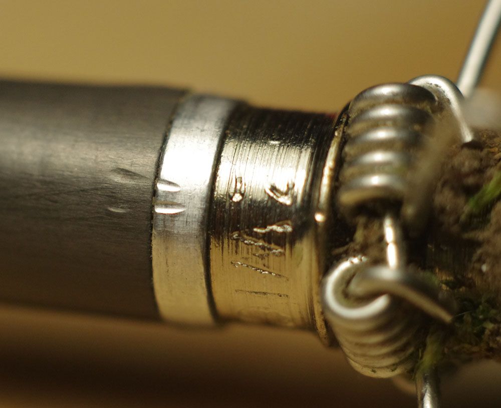

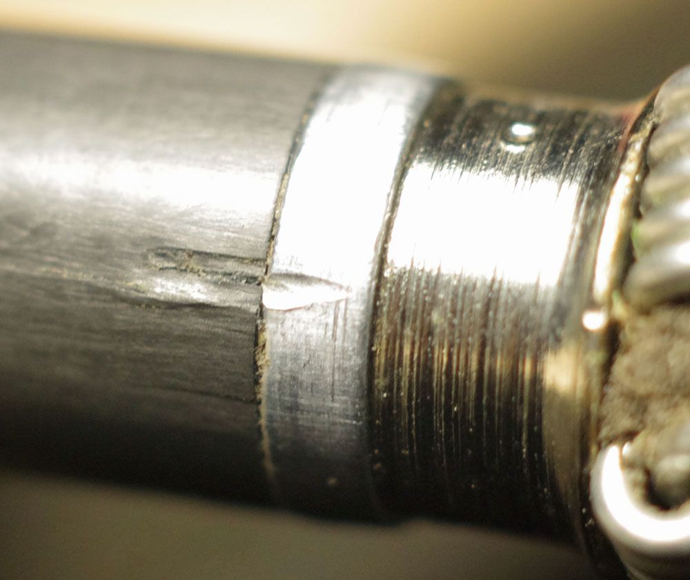

I tried out a Zwickey Judo point this evening. Two water bottles were eviscerated and the sod was aerated and the arrow was stopped as advertized. I was quite impressed. The carbon shaft was also quite impressed where the spring arms were slapped back on impact thus scoring both the aluminum insert and the carbon shaft.
I can already see a hairline crack forming and suspect that arrow is already compromised. Any suggestions how to help prevent this? I was thinking that a small washer that has an OD larger than the arrow/insert might spare the arrow from being flogged. The package with the points said that one Judo point would outlast a hundred arrows, but I didn't suspect that the points would be the cause of the arrows' demise.

fy6Maybe adding a small metal washer slightly larger than the shafts od . It would limit the amount of travel the spring arms have .

Try the Zwickey Small Game Getters, also known as
Zwickey Scorpios Broadhead Stoppers with a field point. They slide up the shaft on impact.
