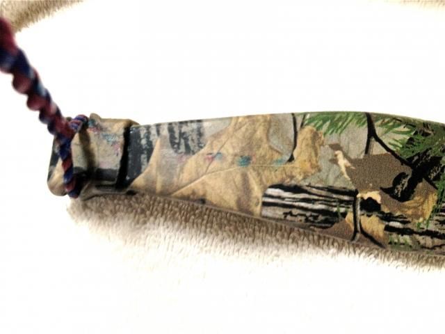

Here's a good example... The dye rubbed off one of my strings onto the limbs but the point is you can see how much contact the string makes with the limbs on Matrix models. And this was with correct brace height of 1/4" off the REDS. Again JMO but I think maintaining proper brace height is much more critical on a Matrix than on magtip limb models. Understood that the Matrix is the first bow for a lot of people and they may not be aware of this, hope it helps save someone a problem down the road.
edit... does anyone else see the chicken? :lol:

Posts: 7000
Re: My Excal Matrix Blew Up!
Post by amythntr »
John...I see the chicken...but do you see the squirrel and the lizard? :lol:

Kegbelly
Posts: 1639
Post by Kegbelly »
amythntr wrote:John...I see the chicken...but do you see the squirrel and the lizard? :lol:
Anthony :)
I see the squirrel but the lizard is hiding :lol: I'd really like to see a deer :mrgreen:

Pydpiper
Posts: 6148
Post by Pydpiper »
Anthony :)
The deer is on the "other" side of the limbs.
paulaboutform
Posts: 4970
Post by paulaboutform »
I couldn't find the squirrel or lizard but did see the partridge beek to beek with the chicken....and the second partridge's beek behind the first one. :D
