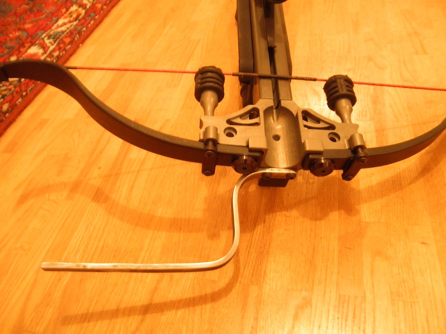

Anyway, my first design was a fail. I figured, why a T if I only use one foot anyway so I made this:
It does allow you to keep your back perfectly centered but I wasn't able to keep the crossbow down while cocking, the left side, which wasn't held down, kept riding up. It seems you have to use both feet when placed so far apart.
Next I'll make the same thing but mirrored on each side.

Overkill wasn't my point. Having the right size line for the hole and zero stretch was. If it stretches any at all, the bow is coming closer to you, meaning that you have to pull higher to get it cocked. Not good!!! :oops:
The reason that your bow was tilting is simple: the foot holdown is offset from center! If the load isn't centered, the how will tilt. Physics.
Anything that adds weight or even keeps it close to the same is not an advantage, for me. The one thing that I REALLY do dislike about this thing is the weight, especially the weight on the riser end. Compared to my ancient MQ1, it's forces me to think about getting through the woods instead of thinking about the woods, and what's in them. :roll:
Everything is a compromise.

Absolutely right, I just sometimes tend to make something without thinking it through :? I'm usually wiser in the end and smack myself on the head for being so stupid :lol:
Anyway, I played around some more with the rope stirrup and I think I'll stick with it. It's perfect, really. Cocking is much easier now that I can keep my spine and bow centered and it also weighs next to nothing. I don't think any T-bar design can compete with that.
Now the challenge is to find fitting rope, the pink/blue stuff that I have works but it's really not exactly easy on the eyes :shock: Can't do that to my Nightmare :lol:
