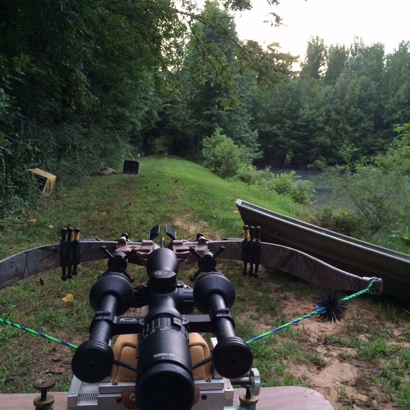

Here is a thread I started a while back of myself shooting 100 yards... I listed all my gear and arrow specs..
http://www.excaliburcrossbow.com/phpBB2 ... =1&t=62317

My most accurate set up to date, with my M405 , is with an Optimizer, Duralyt 2-8 (VXR 3-9 is a great choice!) , Dr Stirrup stirrup and string bumpers, TT trigger, a good, forgiving string from Boo or Vixenmaster, cocking with C-2 (more consistent), Optimizer extension, I use an arrow retention spring with relatively low tension on the arrow plus double shrink wrapped. I've found that 26g insert and 170g point is adequate for great groupings but have since gone to 50g inserts when using 3" vanes. SK300 slightly edged out the helical Blazers in accuracy testing.
Big John, Boo, and Jerry all make class act arrows. Extreme accuracy can only be obtained with custom, matched arrows. I've found the Schwackers and FOC broadheads to be the most accurate. With these near field point broadheads, 195g total weight is sufficient for helical Blazers and plastic nocks. For SK300sor other 3" vanes or heavier inserts, consider 210-220g total point weight. Use benchrest technics.
FWIW, my BD400 is shooting very slightly more accurately than my M380 &M405.
Though I don't believe this is a factor even in long range hunting, the BD400 seems to have a slight accuracy edge over the M380&405. The power stroke of the BD is slightly longer than the 405 yet the poundage is 10# less which is likely a factor. I have 2 stage 2.5# TTs in each Matrix but just the untouched factory trigger in the BD. Yes, there is a difference; but I haven't noticed any adverse effect accuracy-wise or negatives in general usage with the BD trigger. I'm currently torn between the M405 and the BD. The M405 is 20'/sec faster but isn't quite as well balanced as the slightly more accurate BD400. Which ever one I'm using is my favorite Xbow .
