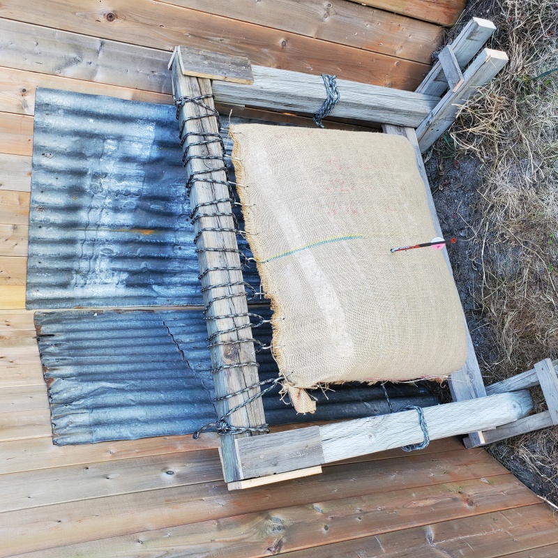

For the backyard I use a larger version strung up on a home made stand from discarded wood fencing held with rope for a bit of "give" or energy absorption.
Again, rags, jeans and scrap canvas layered in a heavy duty coffee bean sack. I found a box of duty coffee bean sacks at my local Surplus store
5 bags for $2.99 .
The arrow stuck in target was 400 gr at 500 fps.
Note: steel background for safety.
A roof keeps rain and UV off this target for longevity. Protecting any outdoor target is very important.
