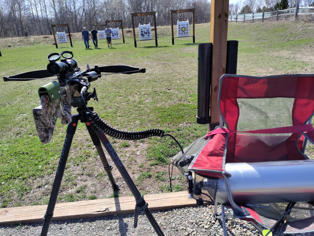

Put my Excalibur steambow through its paces at the range today. Have a small 9 ci hpa tank to act as my regulator, connected to a fill station connected to the scuba tank. And remote line running up to the steambow.
The steambow was originally a Micro 355 version, but I swapped matrix limbs into it, and put a Matrix Sapphire stock on it for the shorter LOP.
Reason I put the matrix limbs in it was to slow it down enough to be allowed to shoot my local 3D course. It'll put em all in the bull 20-40 yds every time as long as I make sure the string is centered in the latch after pressurizing the cylinders. Silver sharpie for now to mark the string centering marks. Long term I will probably have someone put a layer of different colored serving on each side to help with centering.
Next step is to work on a good way to secure the scuba tank behind me on the Rig so I can use that to get around the 3D course.
