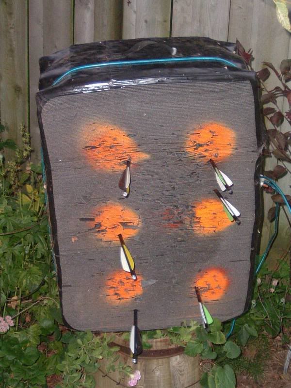

Okay so tonight I went and switched the Thunderheads onto the Beman's, and the Wasp Boss's onto the Gold Tip's... and BINGO
They're shooting exactly where I point them. They look like they hit on funny angles, but it's actually cuz my target would spin a bit everytime I shot a bolt into it. :lol:
And here I am 8)
TYE
Posts: 5136
Post by TYE »
Those shots are actually kinda brutal, but I was just sittin there shootin' off hand and knee. Not really taking my time. I'm just happy cuz those beat the hell out of what I was getting before.
