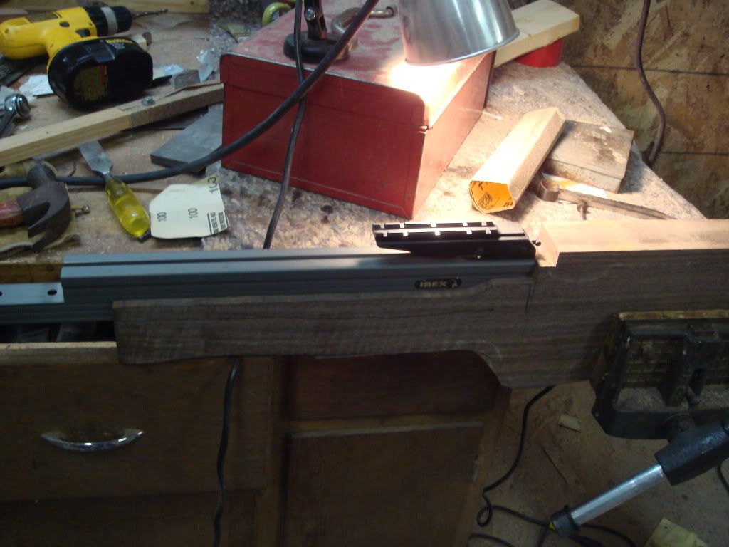

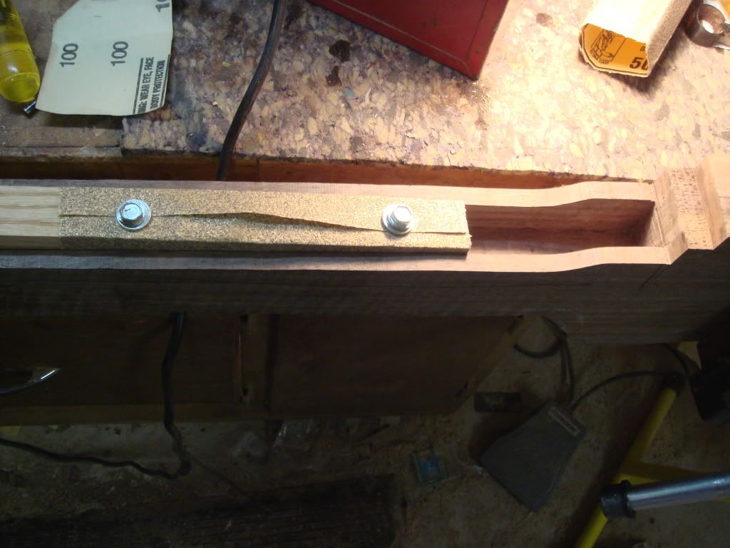

Sorry it took so long. Did I mention that I am slow. Here are some pics. the jig in the rail is just a piece of wood cut close to the width of the finished rail with sandpaper attached. Just slide back and forth and wear yourself out. I mean sand it to width. Next step is locating the trigger holes an the thumbhole.

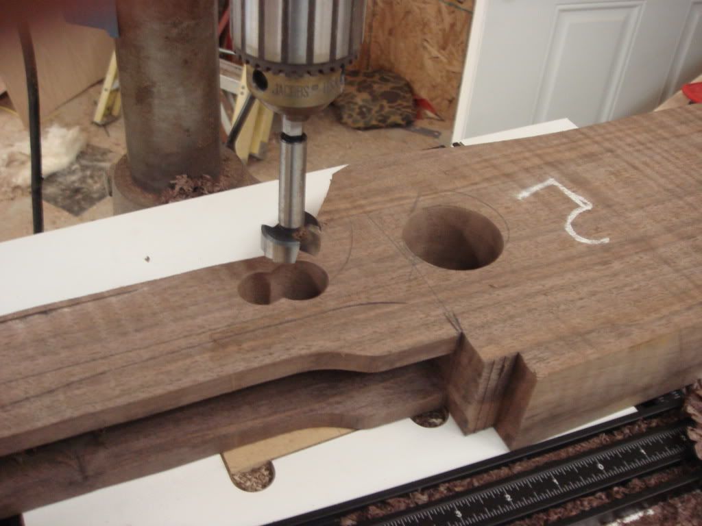

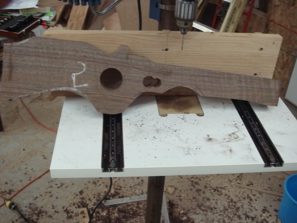

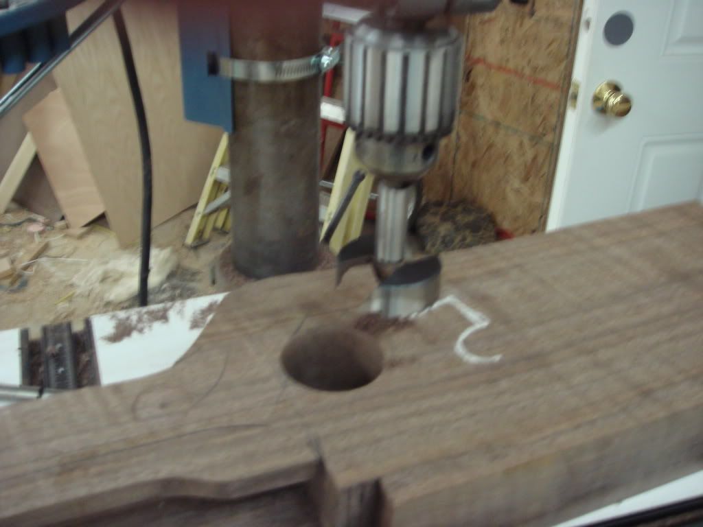

Well, I drilled out the holes for the trigger and thumbhole with my forsthner bits. Next bandsaw off the excess wood and mark centers for reference.

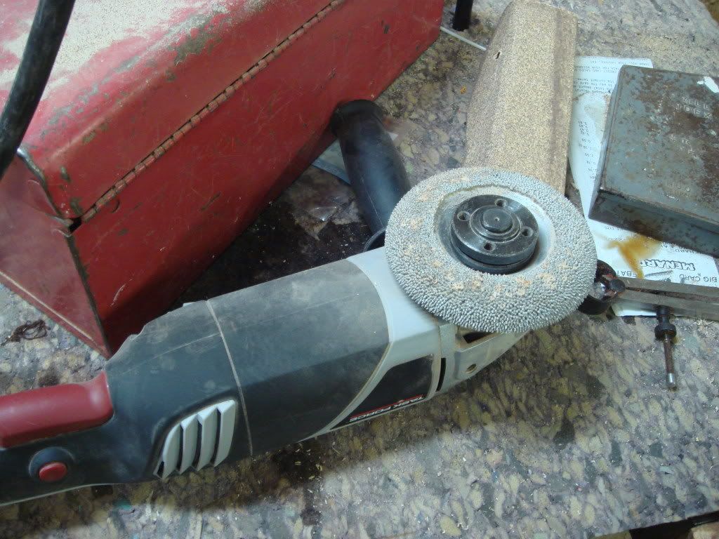

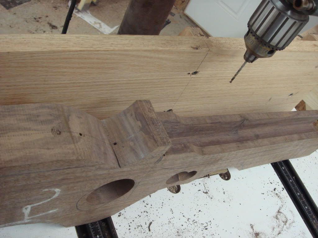

I cut off all the excess and drill small but deep holes in the center of the stock every 6" or so. Gives me a reference for keeping everything straight. The tool with the mean abrasive teeth is my eliminater. Cuts like butter.
