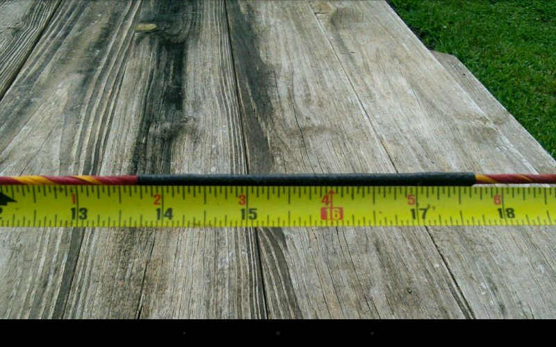

I went home and put a string on the stretcher and and lets say its centered perfect on the rail . 13 3/4 - 17 3/4 ( 4 in. serving ) .
[URL=http://s154.photobucket.com/user/1longb ... 3.png.html]

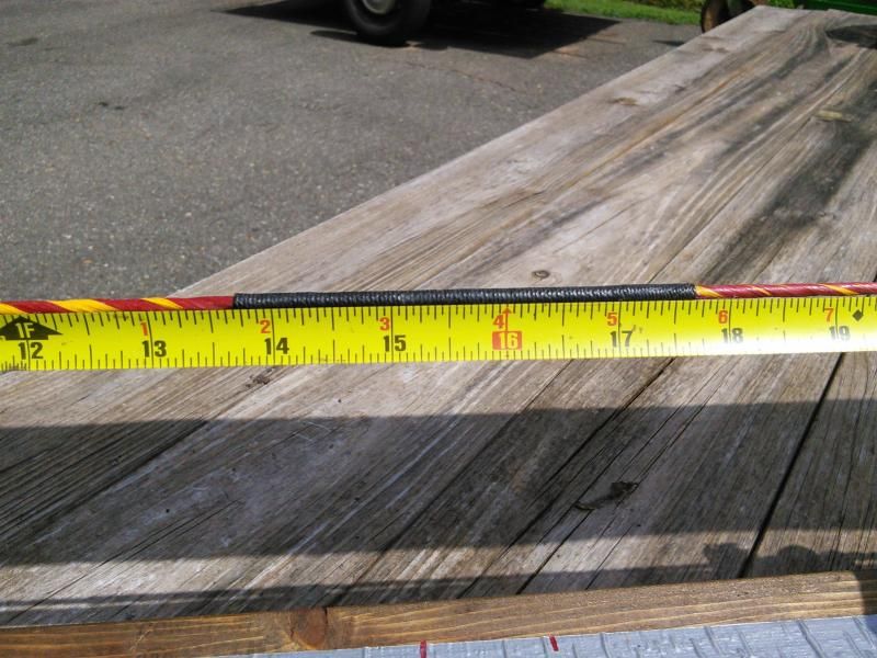

Then I added 4 CCW twist to it .
[URL=http://s154.photobucket.com/user/1longb ... 2.png.html]
As you can see it did move the ends SLIGHTLY like I said . No big deal at all , Doesn't hurt a thing . But to say the ends don't move at all isn't exactly true .[URL=http://s154.photobucket.com/user/1longb ... 2.jpg.html]

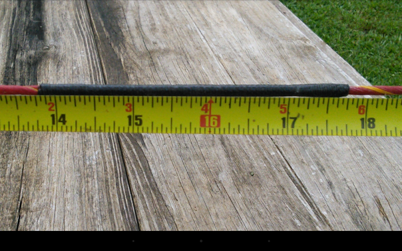

This last picture was took 3.5 hours after the 4 ccw twist were added and as you can see its still at the same place and wont move back . This string is a 40 strand BCY-X Flemish that has all the stretch pretty much out of it . Results might vary with different strings and materials but this is what Im seeing .
