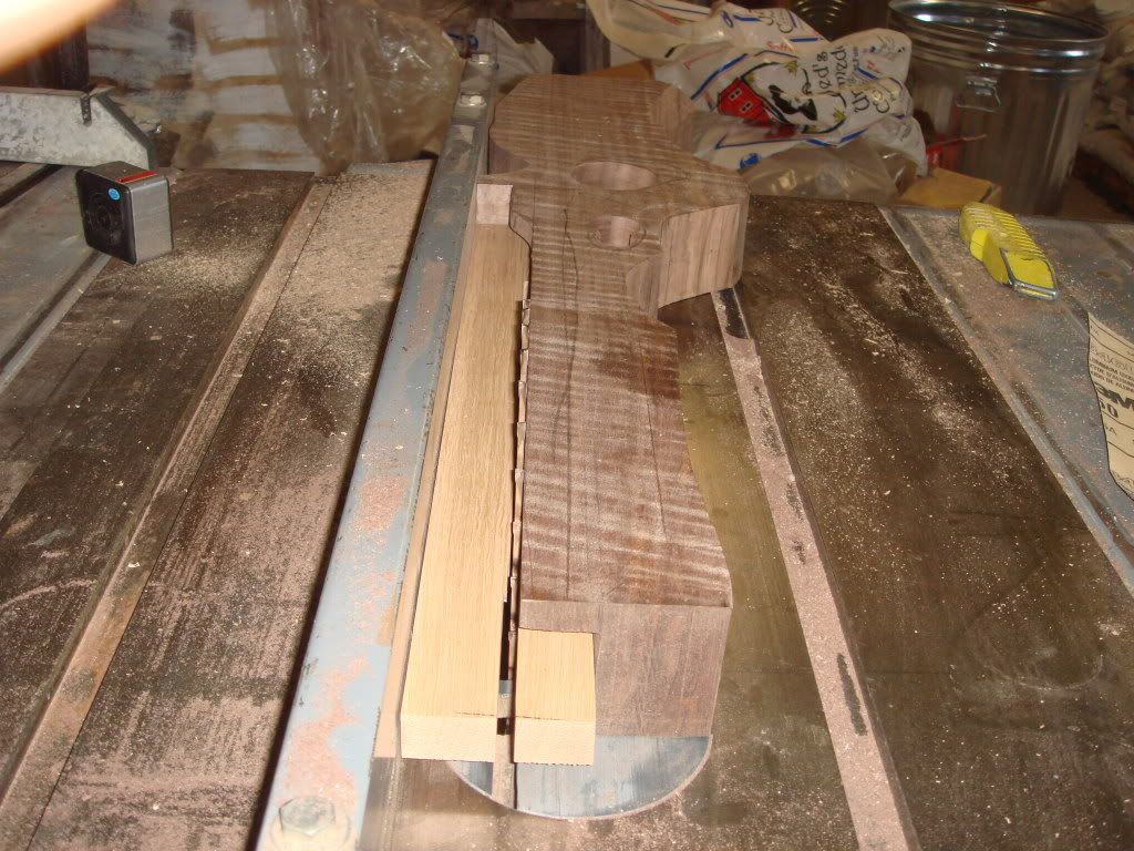

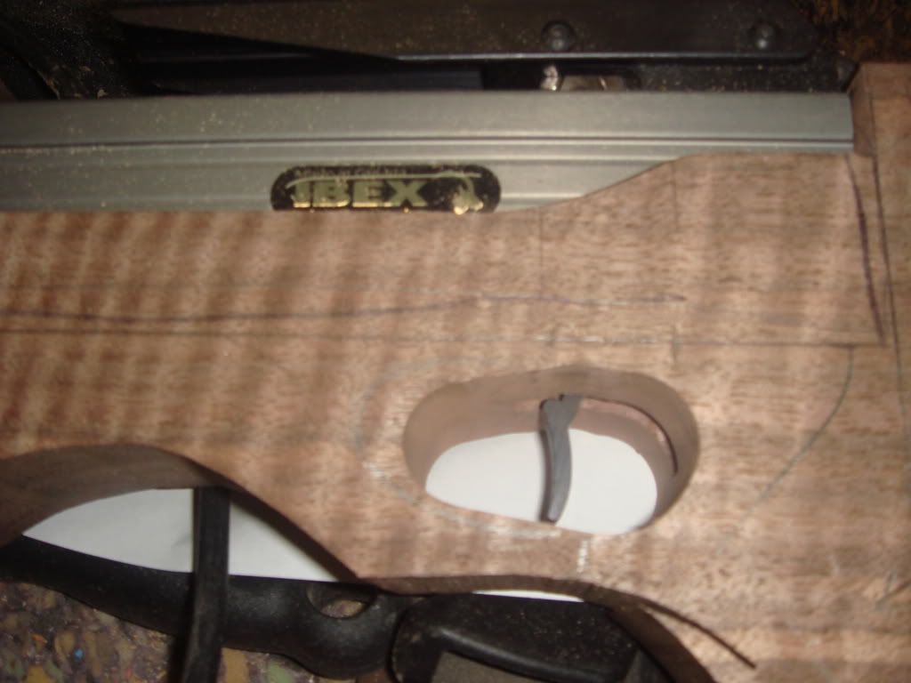

Finally getting better. OK. The first photo is the way I make sure the top of the stock is parrallel to the rail.

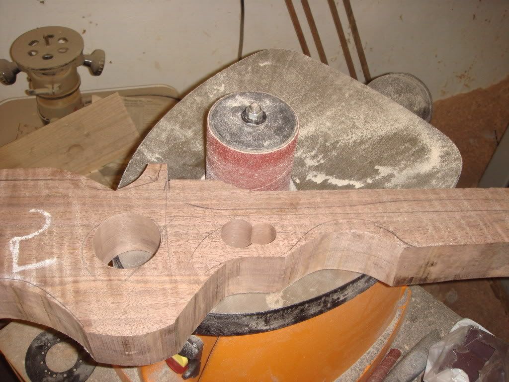

This photo is of using a spindle sander to square up the curved part of the top of the rail.

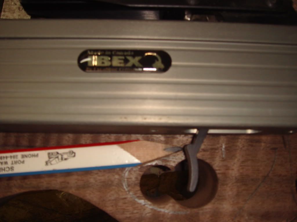

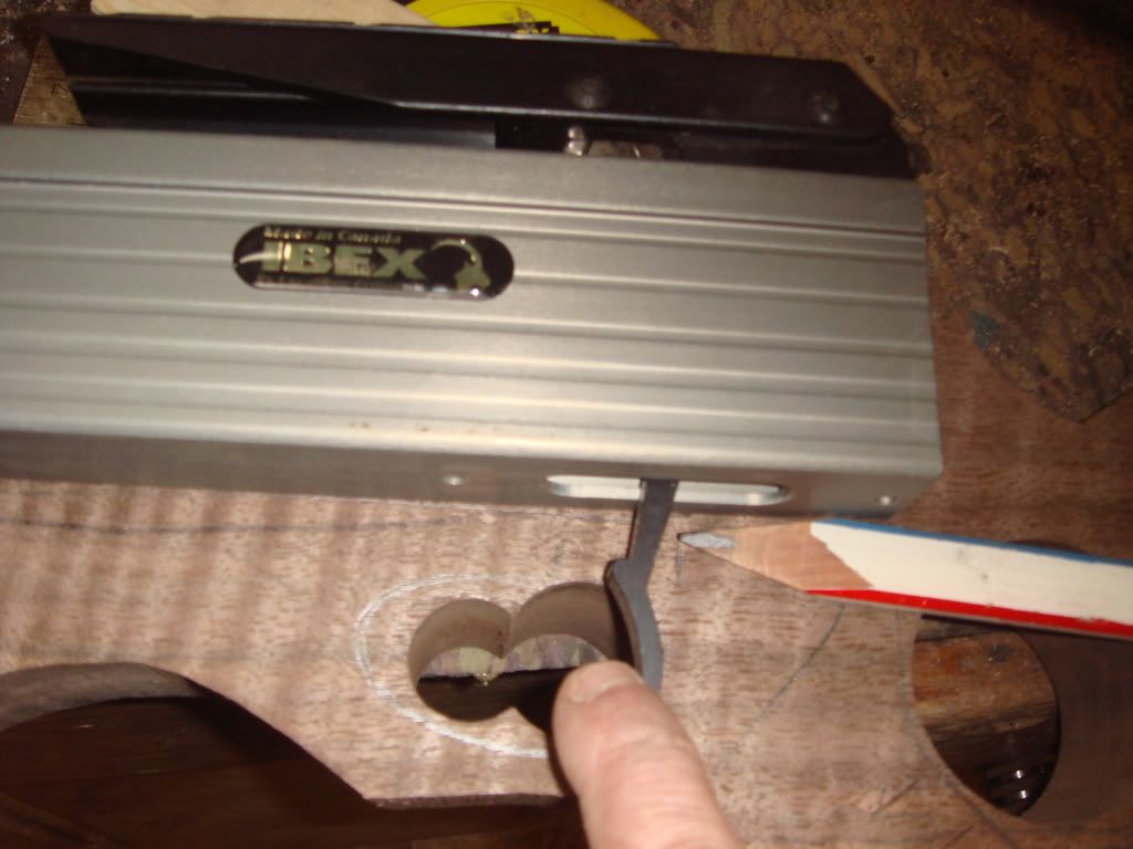

This photo is of locating the trigger using the crossbow rail butted against the butt end of the stock rail. (trigger relaxed)
The last pic is the trigger engaged which would be the butt end of the trigger slot. Just square the marks around to the inside of the rail and drill out the trigger slot.

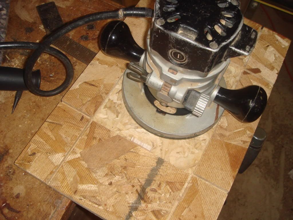

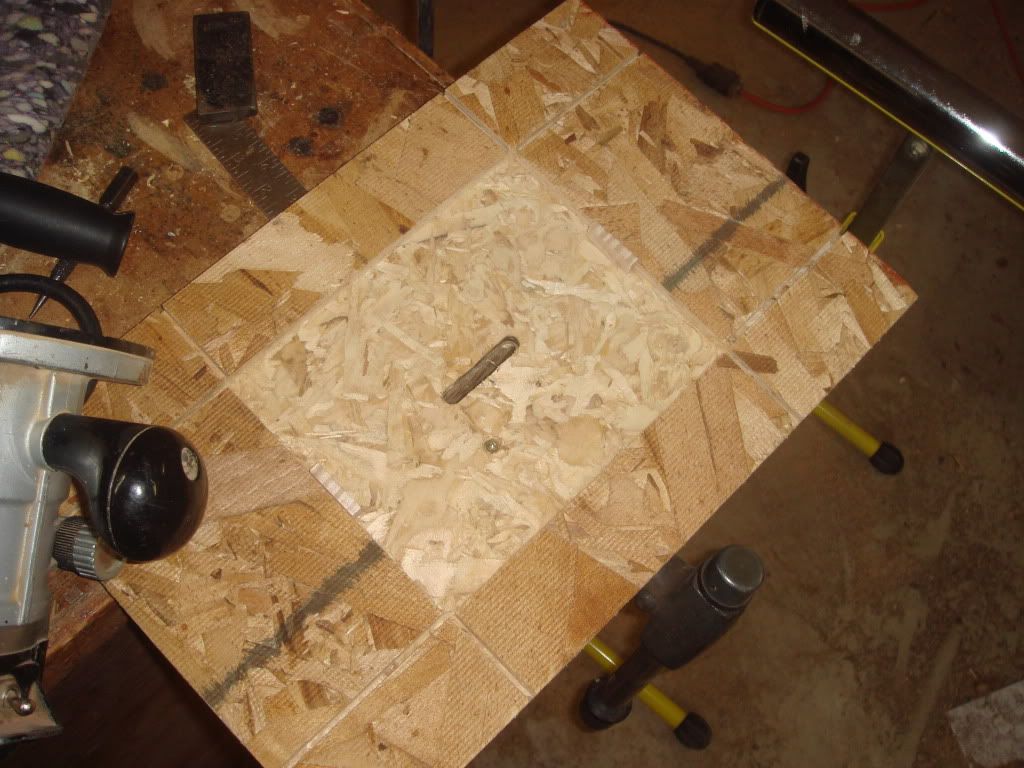

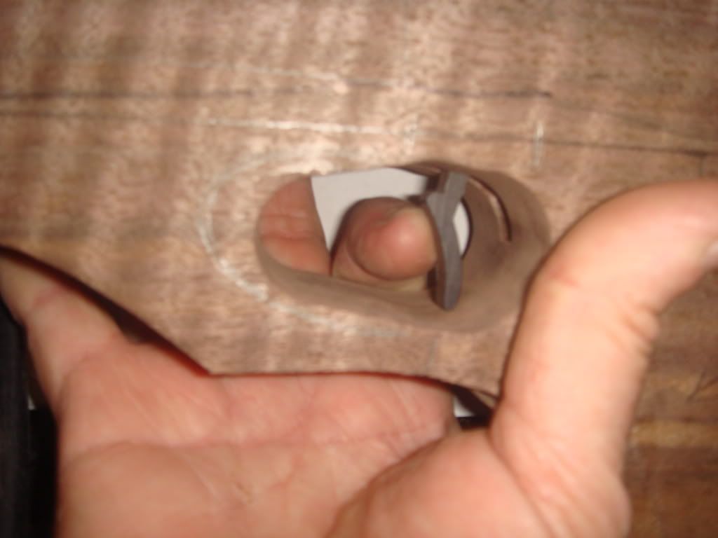

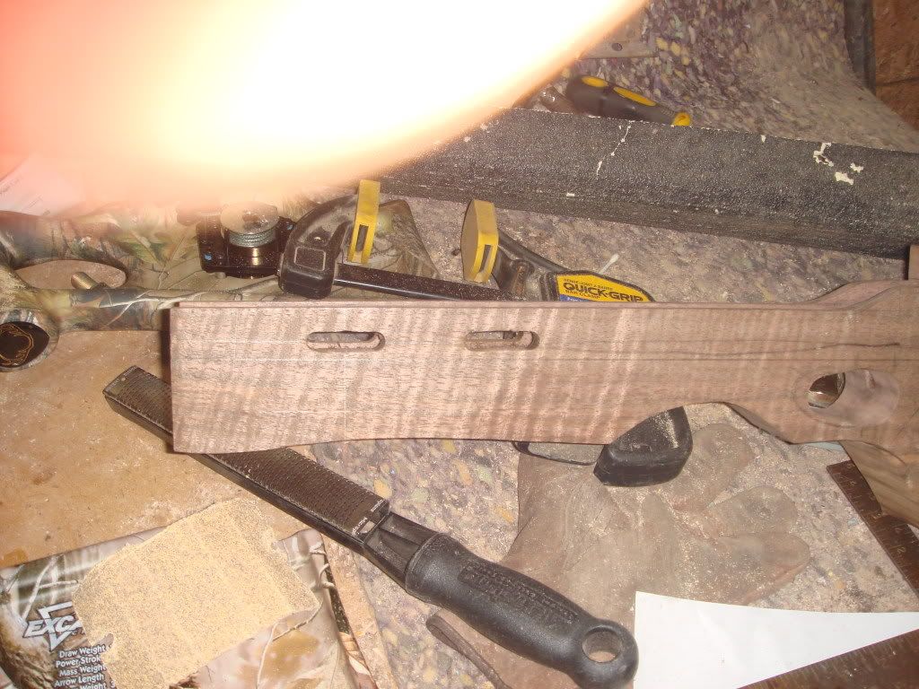

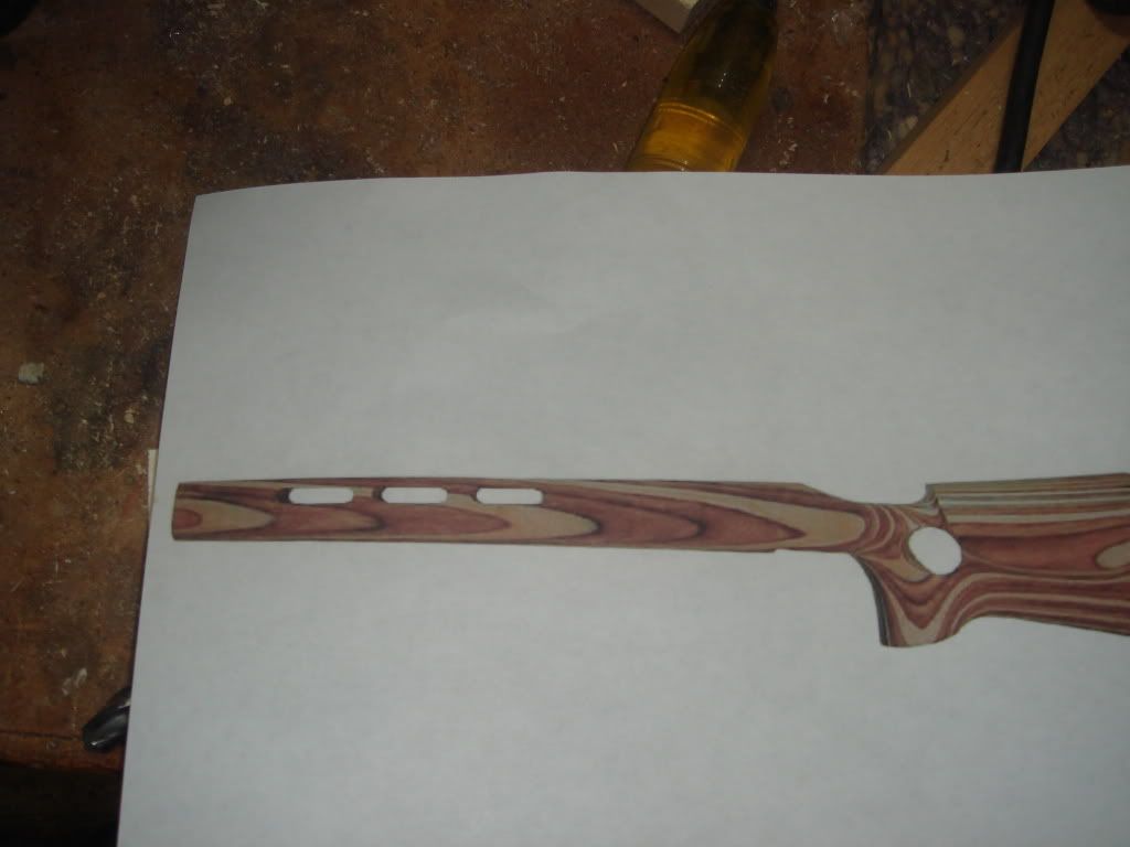

This pic is of the trigger hole finished out so the trigger has good travel
This is something that Don wants to cure an overheated rail. He shoots a lot.
These three pics are of a jig I threw together to make it easlier to make the slots.
next pics of how it turns out.Thanks for looking; Mike

Re: Boo's stock
Overheating a rail............. LOL............That's funny!!!!!!!!!!! Don't think I could load arrows that quick let alone cock it!!!! Guess being under 6 feet tall has it's advantages. LOL

Stock is short so I made just two slots. Don will have to shoot less to keep the rail from overheating
