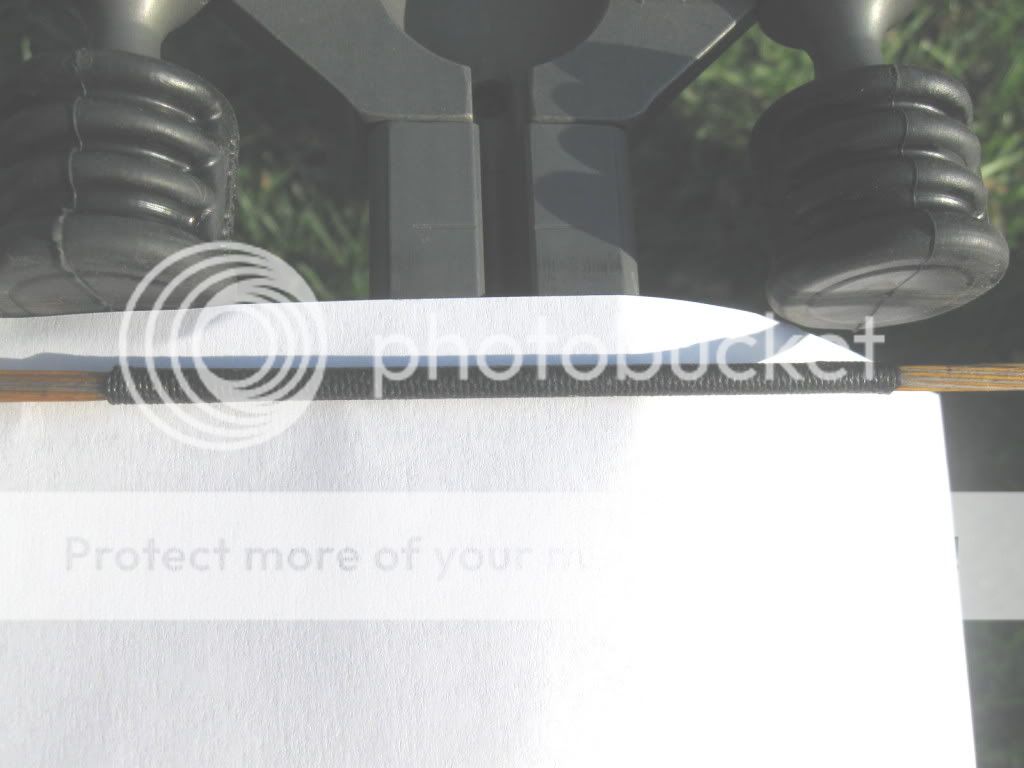

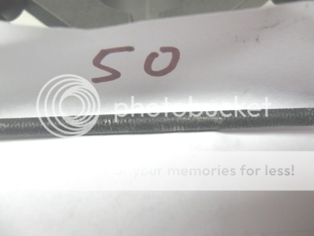

Re: Excel string with 0.035" Angel Majesty Test
got the string in today. first thing ill say is i like the diam.
it just fits the arrow well IMHO
here it is on the bow no shots siting just above the highest brace line
got 50 in . serving still looks good. normal dents but no fraying or seperation. i did creep to about 1/8 bellow the high line. so far its staying put..ill wax it and try to get 50 more in tomorrow.( this pic is with me rolling the string so it shows the latch side)
