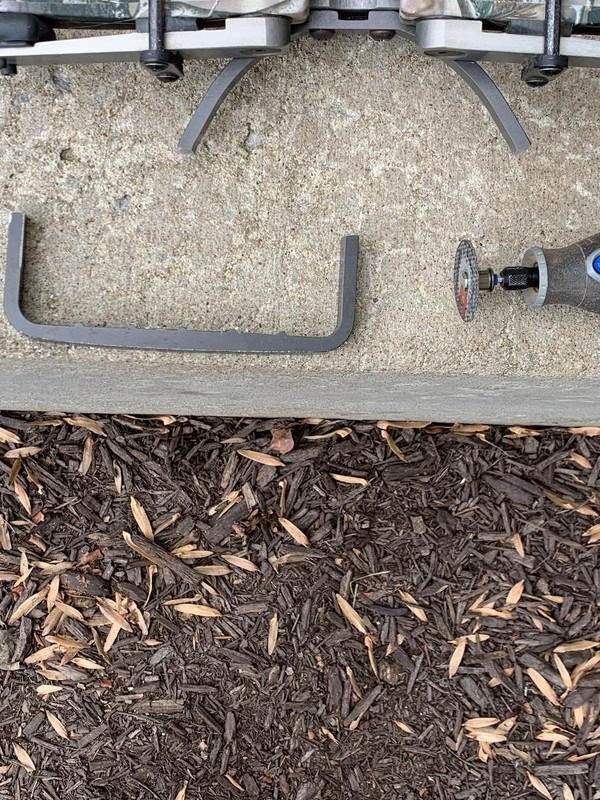

Want to put the Bigfoot Stirrup on, cannot remove the bolts, broke the ends off two ball end allen wrenches, and NADA! I have a hand held Impact Screw Driver coming today with hardened bits for hex head screws, so the last thing to do besides getting the tool was to get the old stirrup out of the way to be able to use the impact driver. More to come folks.

Dan, do you think that if you heated the head of the screw just hot to the touch with a micro torch would harm the mainframe?
When you’re using the allan socket don’t forget to beat it in like it owes you money. :mrgreen:

Yes I think it would mess of the finish on the riser. These are rusted in place, and steel and aluminum are a recipe for this sort of issue. I'm using the antique model impact driver that you have to whack the end to get any turning force, so it's gonna get a beating alright. :lol: :lol:
I did speak with Don about this fix the other night, and he pushed me over the edge on my decision! :thumbup: :thumbup:
Hopefully this works, and I will post a pic. or two of the device later, if it actually arrives today. :eusa-popcorn:

We use impact drivers to remove rusted allens that hold on drums and discs. We always give the fastener a good snack with a BFH before going at it with the impact driver. The advantage of the tool is that is does compress the threads during the moment of being turned. I can’t see how you can not win this fight. :thumbup:
