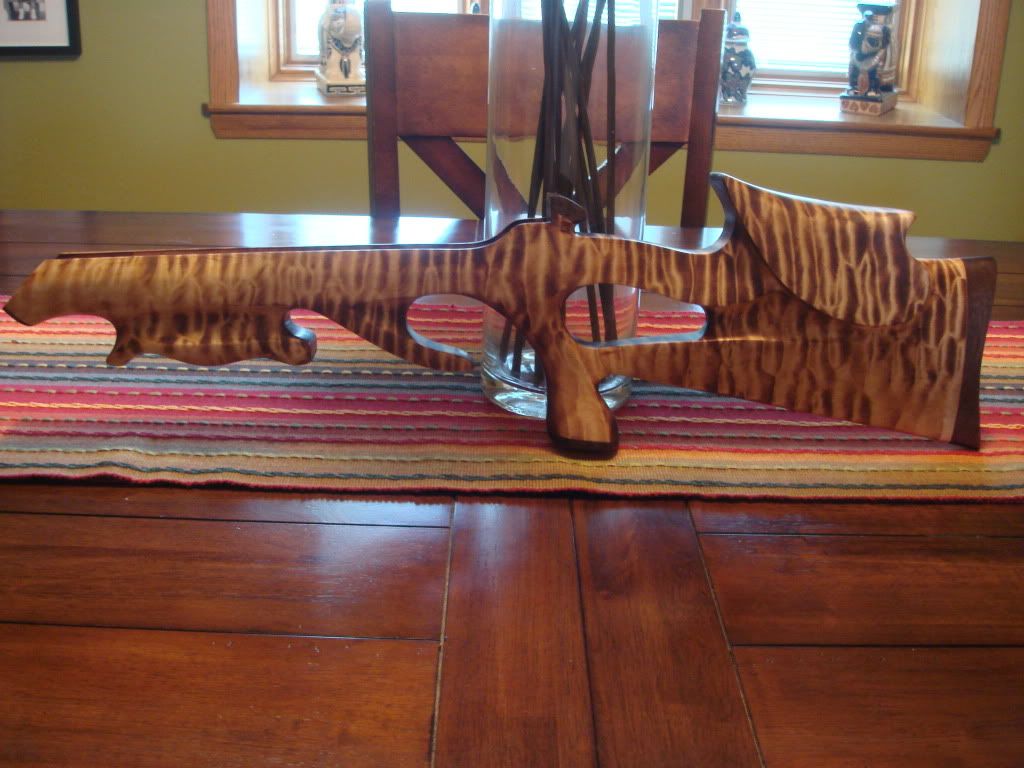

My first time using the new finish with the stock stained and found out it does not work very well so I am going to sand it down and do it over. Just did not turn out right. OH, WELL. :roll:

Sanded it all down and put the finish on and it is done.

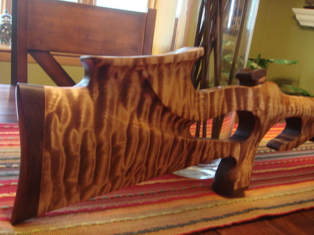

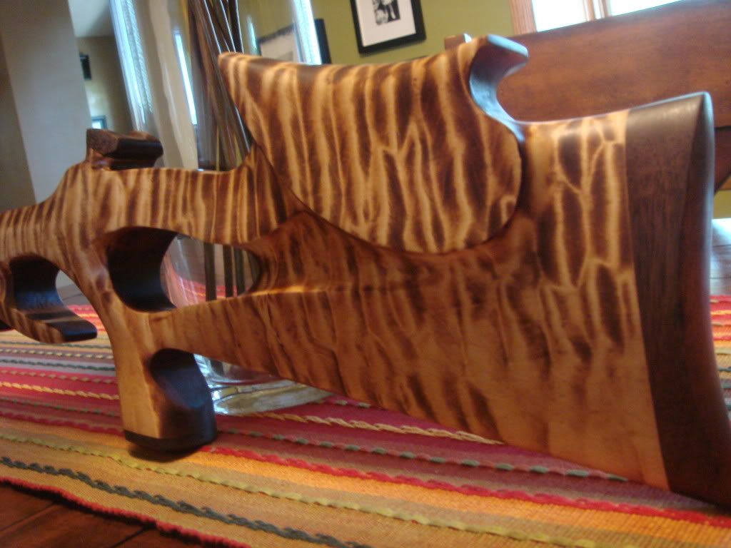

Thanks Stan. I want to mention that Gary M. lent a hand on this by sending me some one eighth inch brass rods. I put one on either side of the cocking catch. Gives it super strength greater than the mere human. :D I can not see it breaking. Oddly a crack appeared on both sides right in the rope cocking groove. Must be something to do with the exetreme Quilted grain. That grain goes everywhere. With that type of grain it is hard to tell exactly where the strength is and where its weak. The pins will take care of that problem. Thanks Gary. Its a great idea. :D

agingcrossbower wrote:Thanks Stan. I want to mention that Gary M. lent a hand on this by sending me some one eighth inch brass rods. I put one on either side of the cocking catch. Gives it super strength greater than the mere human. :D I can not see it breaking. Oddly a crack appeared on both sides right in the rope cocking groove. Must be something to do with the exetreme Quilted grain. That grain goes everywhere. With that type of grain it is hard to tell exactly where the strength is and where its weak. The pins will take care of that problem. Thanks Gary. Its a great idea. :D
I wondered about that area..on mine i worked hard to get the rail to butt tight against it thinking it will be stronger ..but after a few sesions of shooting i can see a gap ..i think it crept foward much like the riser joint does.
that brass rod idea is a good one..can you show any detail pics of that ? if i am understanding you put them vertical on eitherside of the groove and caped it off with a darker wood?
what realy caught my eye is how perfect the buttplate is joined to the stock. thats a tough joint to get right..fine job :D

Here you go Strum. I didn't trust the wood with the cocking rope so I drilled the stock and epoxied in the brass pins. The pins are 1 3/4" long. Mike made a little walnut cap that covers the pins on his stock. Gary

GaryM wrote:Here you go Strum. I didn't trust the wood with the cocking rope so I drilled the stock and epoxied in the brass pins. The pins are 1 3/4" long. Mike made a little walnut cap that covers the pins on his stock. Gary
thanks gary,,that a great idea ..ill keep an eye on mine. if i see any more movment ill do that trick :D i think i made mine a bit beefy er than you guys so it m ay never give trouble we'll see

The stock looks great aging. I like the lighter colour better. Gary the brass pins are a great idea, the direction of the grain in that area does not offer much strength. The little brass "dots" are a nice accent against the dark wood.
