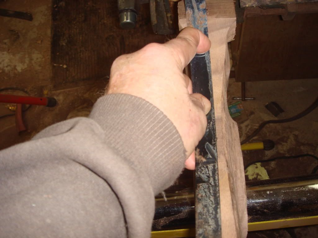

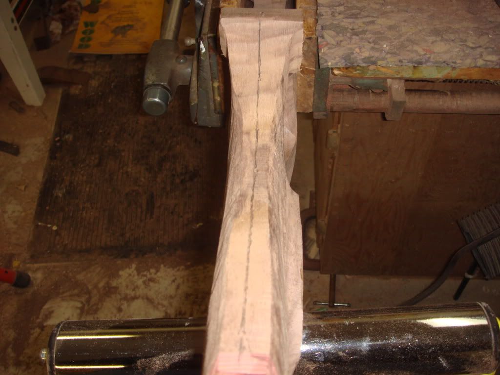

This is one step in the process that I want to post again. Its helped me keep track of center after the blank loses its edges. It has proven to be (othet than blood letting) one of the better idea's that came out of stock making for me. First pic show using a flexible metal banding strip I can lay the strip down on a curved surface, line up the holes and draw a line dead center.Image

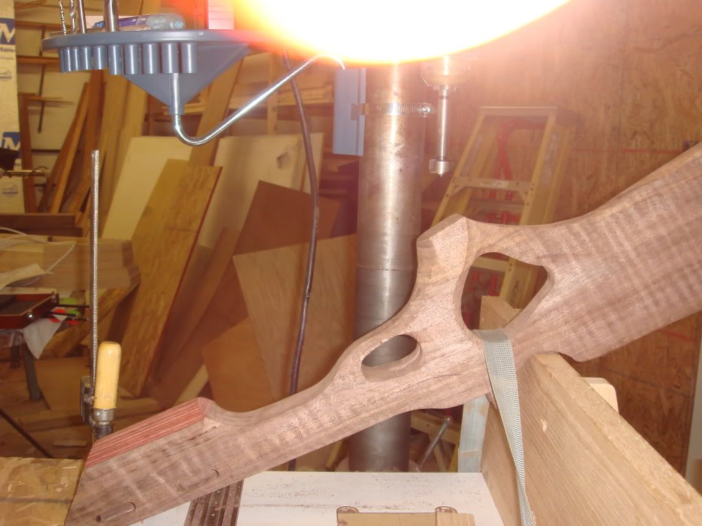

Here it is after the line is drawn and the holes running down the center. Of course all this is mute if you don't drill the holes straight into the wood.Image

Starting to change. Trimming the fat.Image

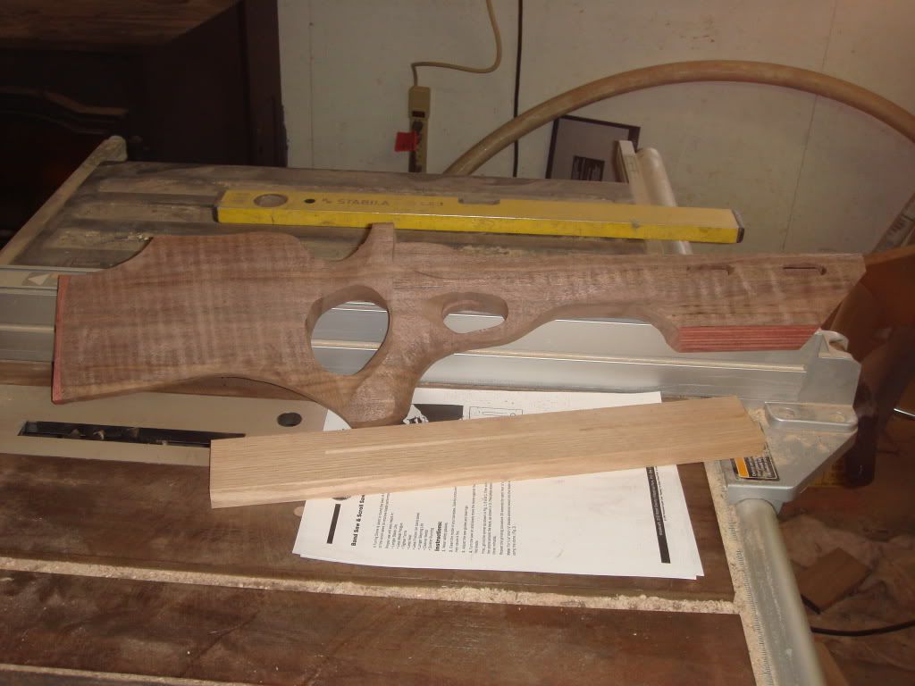

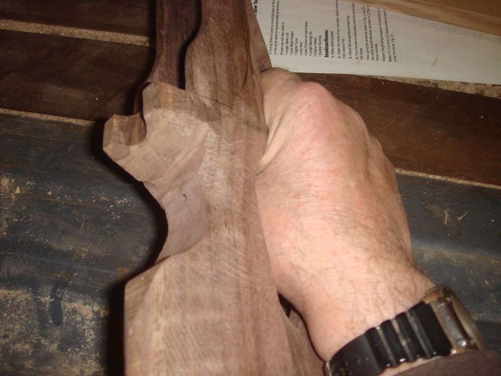

I'm doing a lot of shaping, keeping track of the centering holes and taking off weight anytime I can.Image

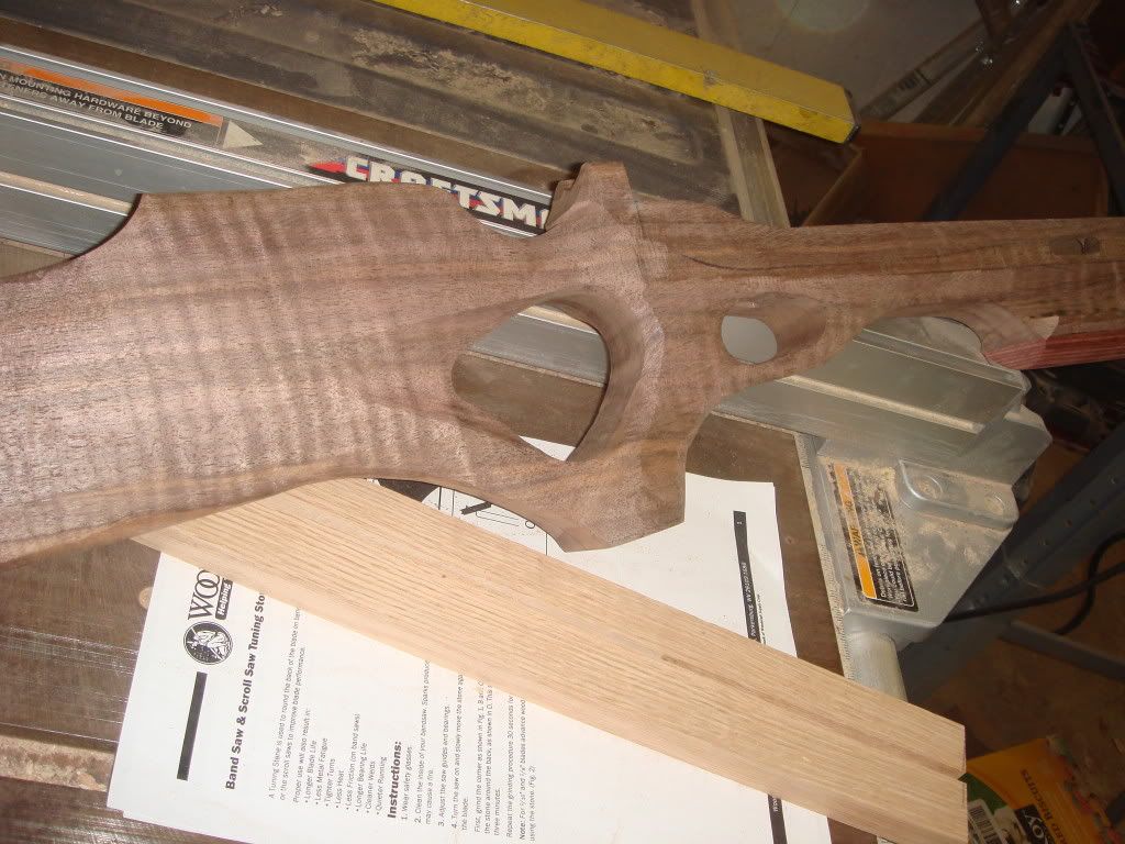

I like to exagerate the thumb-hole so you can slid your hand into the grip. Just my taste. Image

Boo wrote:You are a patient man Mike!
Oh Don, there is a lot of shaping left yet. And, then I can start sanding from 50 grit all the way to 320 grit. And lastly the finishing which is a drawn out process. There is nothing fast about making a custom stock. Thats the huge difference between a CNC punched out stock and one made just for YOU. :)

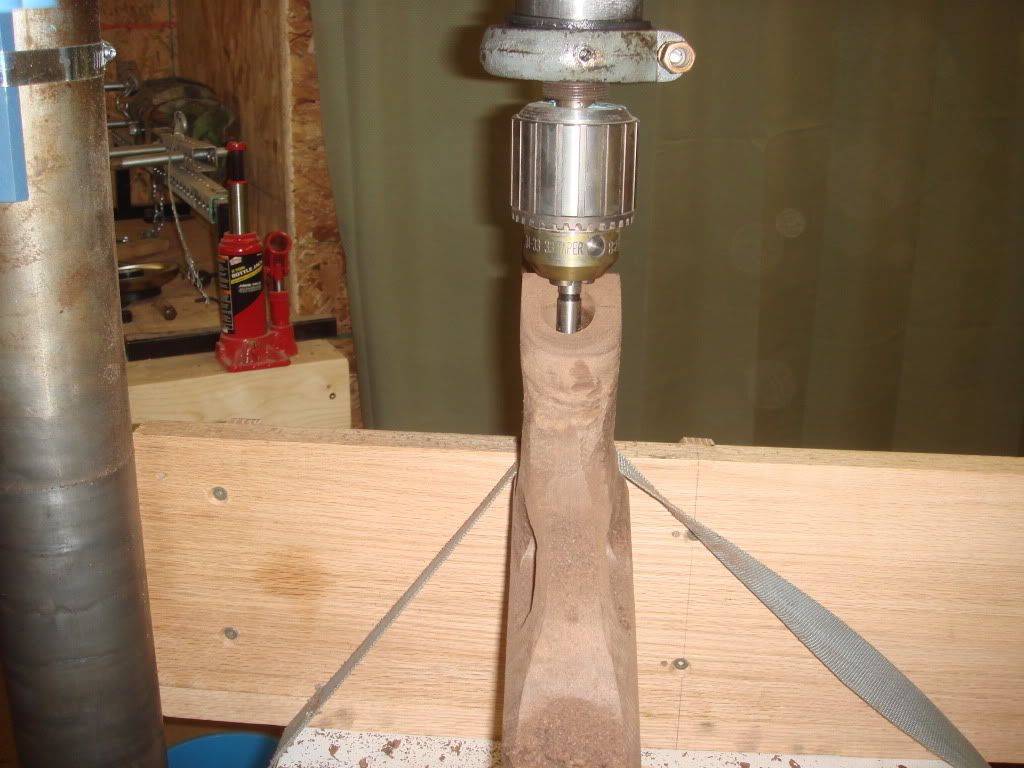

I'm going to drill a hole in the grip to remove a little weight.Image
