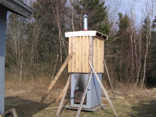

Thanks for the info and the comment about my smoker. I will be glad when I can feel well enough again to finish it. I am looking forward to trying it out. I may have to make some modifications but it is a learning curve for me. I couldn't afford to buy one and I had all the material that I have used to build it so here it is. And you know what, it was good project to help me take my mind off of my problems. I have enjoyed building it and if I need to do something.

Hey Ray:
You may want to think about placement of the smoker in your yard.
I would also suggest removing it from the pallet and setting it up on a small concrete pad or patio stones. It would allow you to bolt the smoker down and remove the side supports.
A clean area free of combustible materials would be less of a fire hazard as well.
Take care and get well.

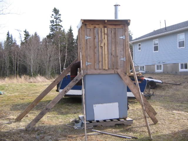

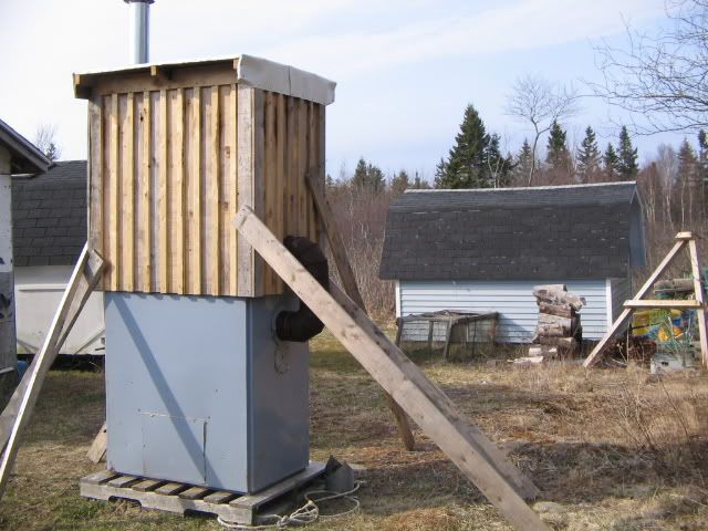

Hey Folks,
Here are some other photos of the smoke house. I made a test smoke on Wednesday, I meant to take some photos and forgot. The finished product turned out really well with two trout and it works pretty good. The temperature held fairly well and with more practice it will be even better. They were delicious. I am going to smoke some haddock tomorrow and will take some pictures.
I had the four inch chimney pipe so I made a draft to go inside the pipe and I also made the cap. I should have took some pictures while I was making the draft and cap but I didn't. I will take the cap off and take a photo looking down inside the chimney and a picture of how I have rigged the lever to close and open the draft as needed .

The next task is to figure out where I am going to position it and have my son pour a slab of cement and anchor it on the slab. I would like to be able to do that myself but I need to have some help for some of the work.
