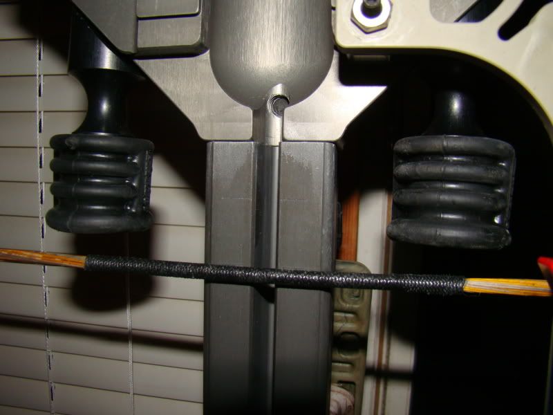

fredbeer wrote:stringdatbow, if it is short of reaching the line, then putting more twist will make it shorter. leave it on the bow a few days which should stretch it some, shoot it 25-30 times, see if that gets it between the lines. if that doesen't work and if you have enough twist in string undo a couple of twist to lenghten it. a pic might help
This is what I have so far, no twist whatsoever, the string is right on top of line kind of hard to see the lines in pic.
FWIW, I see a little twist in the string and no a high brace height will not harm the bow or the string.
Just leave the string on the bow and you will soon have it stretch in.
Your final brace height should be maintained just off the bumpers or the force of the string will split the rubber.
