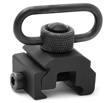

Once you get the tac pac rail installed......consider this: You can mount virtually any camera (size permitting) that has the standard 1/4" 20 TPI thread to your rail by making a camera to rail mounting device from a quick detach swivel/base. There are some youtube videos on this...
Remove the QD swivel from base, drill the hole in the base to 1/4", insert 1/4" 20TPI bolt through hole, add washer, add 1/4 nut to secure the bolt to the base, add another 1/4 nut to run up to the camera and secure it, cut off bolt to desired length (or use bolt of desired length to start with).
