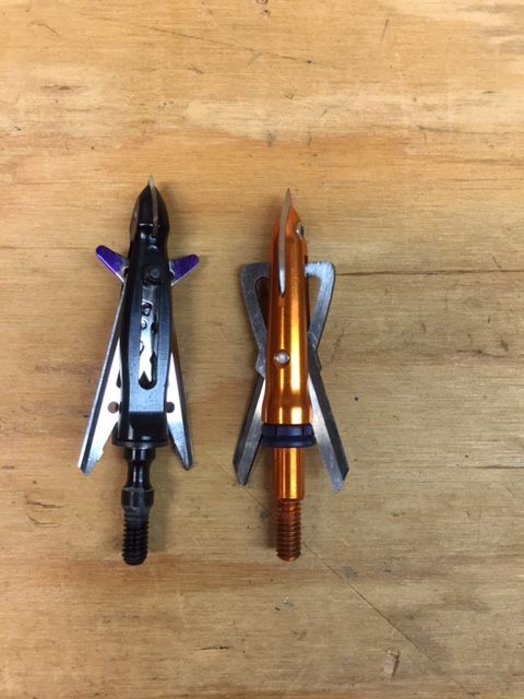

I've been shooting my crossbow and trying to get dialed in with fixed blade broad heads, I've shot 3 different shafts with 3 different broad heads in various configurations and have not been satisfied with the consistency. I just cant get the NAP Devastator/Trocar/Thunderhead to fly consistent enough for me to personally step into the woods and take a shot at an animal. After mulling it over I decided to purchase a mechanical broad head, I went with the Rage crossbow X 100 Gr. I've been shooting the practice head and have gotten the bow dialed in nicely, but I wanted to shoot an actual expandable head to ensued they fly 100% the same. I follow the instructions, screw down the shock collar with the marks aligned, fire the bolt and it sails about 6 feet over the target into the trees/neighbors yard and explodes the bolt. Needless to say I was both pissed and in disbelief, I've never missed the target let alone sail a bolt over the fence. So upon inspection of the bow I identified where the broad head opened before it was even off of the string.... Anyone had this issue and or possible remedy to this problem? see pics below

I too have a scar on the stirrup of my Vortex from a Rage 2-blade that pre-opened. If you think about it, a recurve crossbow is about the worst case scenario for a mechanical head. With a recurve, the further you pull back, the higher the force, so you are always sitting at the top of the power curve when you let it go. That means the BH sees the max force instantaneously when you release the arrow. On a cammed bow, there is let off so the force is lower at the start then reaches the max after the arrow is already moving. You need to take this into consideration when picking a mech. head for an Excal - and even more so with the Matrix line of bows because the draw weights are higher than the older bows.

You mean this ??? Don't use Rage on these High poundage Recurves !!! This had a shock collar and a dental band !!!

I'm actually shooting a compound crossbow, I've got a Barnett BCXtreme... This has me baffled that on literally the first shot I'd have a failure like this, worst part was the bolt flies over the target, over the plywood backing, and over the fence into the neighbors yard. OC right after I jump the fence to recover the bolt the neighbor walks out and is wondering what's going on. The back half of the bolt with the fletching's was lying there, she saw it and gave it to me. Then I'm looking to recover the broadhead, luckily I don't think it looks too dangerous like a fixed blade to the untrained eye. But still I felt like a complete newb...lol
I guess I'm going to try the shock collar and put an O ring on for insurance and try it again, but I'm not going to align the blades with the odd fletching as this was the reason it clipped the stirrup and sailed high

I have never had an issue with a rage broadhead. I guess I have been lucky. If you have lost faith in them, the NAP Crossbow Killzone is another choice of the same style broadhead. I am going to try them out this year, just to try something different. In comparing the two, the Killzone blades are thicker and sharper and are kept closed with an internal clip. The Rage head as you know uses the shock collar to keep the blades closed. While not a very durable head, they produce devastating large wounds and put deer down. I am expecting the Killzone to perform basically the same. Hopefully I will get to try them out this coming fall season.

I'm still using them as well as my other two hunting partners and have yet to have a problem with them. I'm using the crossbow extreme 2.3" with my 380 and have tested them multiple times with the actual head and wasting quit a few shock collars.
not saying that you have them set up wrong but just wondering if that was your problem.
are you lining up the blades with the "crack" of the shock collar??? most people that say they have a problem with them that I've talked to set them up that way and that's not the way to set them up.Crackshot_Benny wrote: I follow the instructions, screw down the shock collar with the marks aligned,
