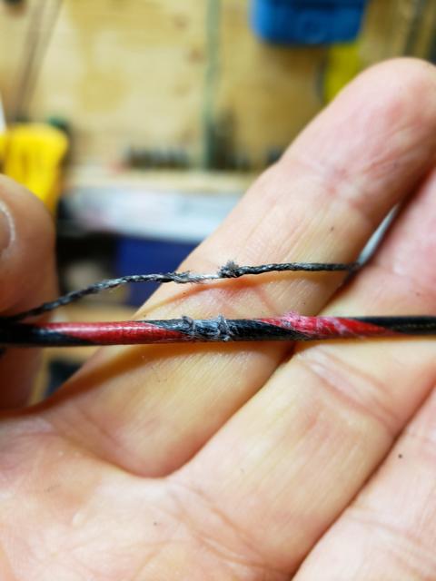

A bit of info on string care. The first picture is what happens when you carry your bow on your shoulder. The fraying on this string is pretty bad and it didn't see much wax if at all. The second picture is what happens when you do not keep your eye on serving wear. The latch chewed through the serving and started to dig into the string itself.

Great words of wisdom. :thumbup:

At worked I'd call that lack of attention to detail! Lol
I check my strings often to make sure they are ready to rock! :)

Those are string issues that should only be dealt with on the night before opening day :eusa-whistle:
A little string maintenance goes a long way in keping everything shooting great!

Thanks for posting Boo
Never realized that carry over your shoulder could cause such wear. That said, I rarely carry mine over the shoulder.

That's nasty. I would never do that to a boo string or any other

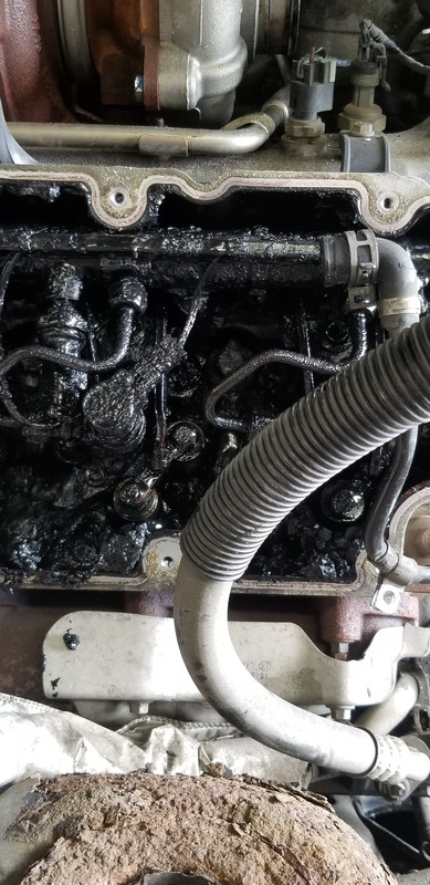

[url=https://postimg.cc/ftQPTQTw]Image
This guy at work didn't like changing his oil on his super duty.......same simple maintenance approach.Engine string all need lube.

That's one dirty head!!

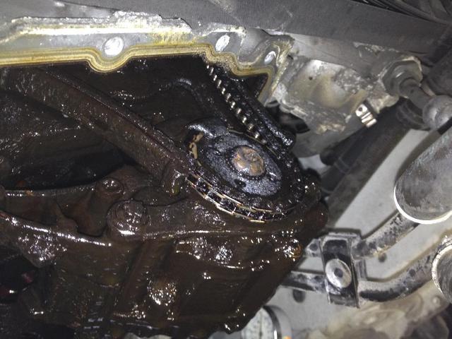

I wonder if that guy is related to one of my customers? Check out the sludge! Guess what? That's his oil pump and it stopped working!

Looks like Quaker State of decades ago or Pennzoil dinosaur oil and slightly overdue a change, actually changes.
