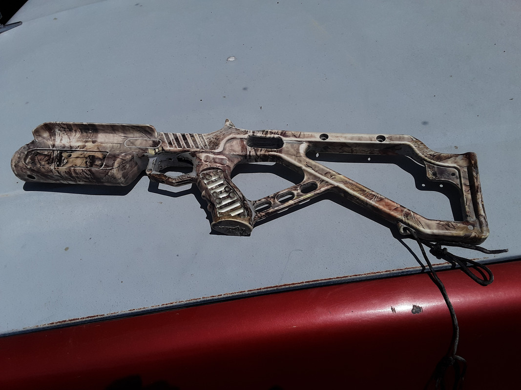

This is one of my first dips olive green base with rugged straight grain. One pic is with matte clear and one with high gloss.
[url=https://postimg.cc/DJBHPDJb]
[url=https://postimg.cc/8FdqjsT4]
This is the first large item I have dipped. After looking at the stock I noticed a couple "irregular areas in the pattern. If I can't blend the area I will strip and dip again. It was reccomended to double dip this stock by taping half the stock lengthwise. I think if I strip it I will try to dip and roll it. I plan to dip and redip if necessary til its right. If I can't get the details the way I want I will paint it flat black then dip it again. The darker the base the harder you have to look at it to see the grain.

That's cool hatchet. It's cool that you did it on your own too. Looks awesome
Re: Clear coat high gloss or matte?
Ya looks cool! The gloss finish really brings the grain out

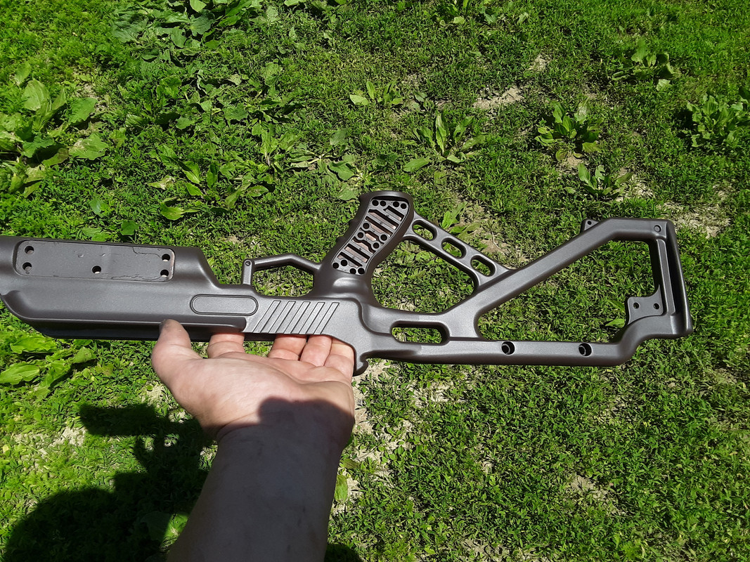

Well here is where I am at now with my hydro-Axe.
[url=https://postimg.cc/nsXTPKFC]
I had a couple imperfections that were about the size of a pencil eraser. Buy the time I was done "fixing" them they were one the size of a quarter. I am going to try to dip this again. I sanded scrubbed and scraped most of the finish off. One good thing is I really got the base deglossed and maybe this will work to my advantage when I start the process over. I still have some cleanup to do but will be ready for paint by this evening.

[url=https://postimg.cc/QKM4RC4c]
Well after 5 hours of sanding, scrubbing and scraping I finally got all of the paint and primer off and put a real good scuffing to the whole stock. I actually got some of the original finish to come off, that stuff is tough as iron and only came off with a abrasives, chemicals and serious effort. At this point the stock was very smooth with some very fine scratches to promote adhesion.

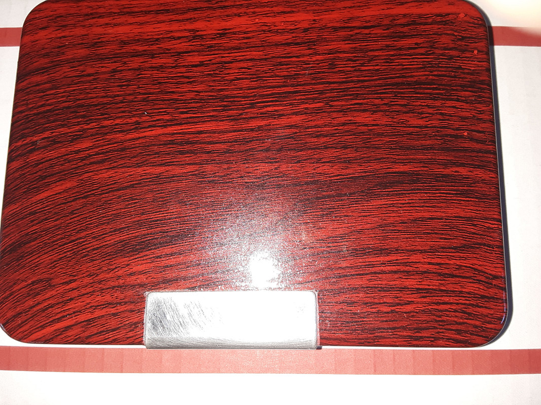

I then shot it in flat dark brown paint. It looked so good I considered putting matte clear on it and calling it finished.... but I am preparing to dip in Cherry wood grain. With this dark brown base coat it should hide some of the fine details along with any imperfections. This is a cheap plastic makeup case I dipped for my daughter. Bright red base with Cherry wood grain dip and high gloss clear.
