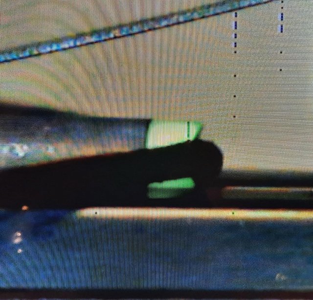

The advantage is that the string will stay centered in the nock. That keeps the string off the deck to reduce serving wear and the polymer nock is far more slippery, hence the speed advantage.
The picture below is a high speed capture on an Excalibur. This whole thing is a surprise for me. Again, the flat nock is pretty simple but the capture nock would be the best for preventing semi dry-fires which is extremely common, much more common than virtually anyone understands.

At the moment of firing a flat nock would produce more string deformation. The string tends to flatten against the nock and is squeezed both upwards and downwards. Upwards doesn't make much difference, but downwards drags harder on the deck. A nock reduces string deformation and consequently reduces drag.
(That's a guess from someone who pretends to know what he's talking about, and instead of pretending, ought to be finishing his lunch and getting back to work.) :thumbup: :thumbup:

FYI, the high speed picture is from Excalibur Crossbows.
The redesign on the Lumenok makes the string enter the nock less abruptly than the traditional nock shape.
