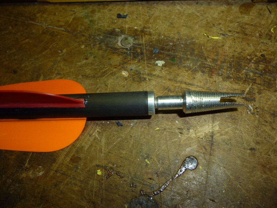

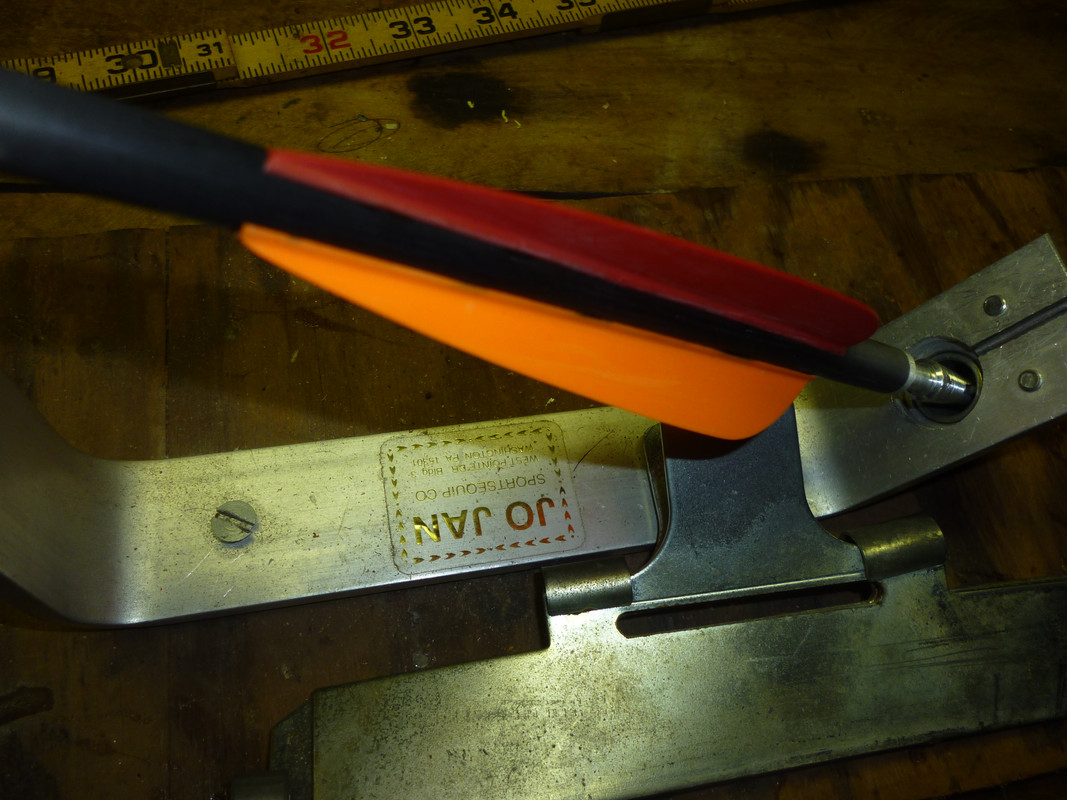

This is how I do it. If the flat nock is unthreaded, I remove it and put in a threaded one. You can then take a steel, aluminum, or brass broadhead adapter and screw it in after you have sawed a slot in it so it will fit the nock indexer. You then have to mark the fletch clamp to get the location you want. Then fletch as normal. Then when finished you can change out nocks if you want.

I use a JoJan with flat nocks. I just dremel'd a slot in an old 38 special brass and it slips over the back of the flat nock snug.

That’s brilliant, Tyler. You amaze mewheelsquad wrote: ↑Mon Nov 20, 2023 10:09 amI use a JoJan with flat nocks. I just dremel'd a slot in an old 38 special brass and it slips over the back of the flat nock snug.

Wish I could claim as my own idea....but it was here on this forum or another one that someone else shared to do that. It is brilliant though, fits perfect! (38 special or 357 mag cases work)flightattendant100 wrote: ↑Mon Nov 20, 2023 10:28 amThat’s brilliant, Tyler. You amaze mewheelsquad wrote: ↑Mon Nov 20, 2023 10:09 amI use a JoJan with flat nocks. I just dremel'd a slot in an old 38 special brass and it slips over the back of the flat nock snug.
