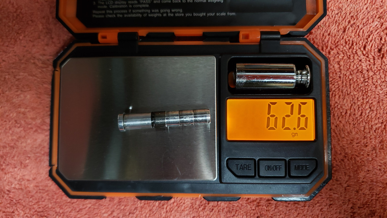

Re: Nock Removal
They are long alrightamythntr wrote: ↑Sun Jul 12, 2020 5:04 pm.....I have been using the 2" screw screwed into the insert. Heat until the screw head glows.....use needlenose pliers to pull....usually takes 2 heatingsjanesy wrote: ↑Sun Jul 12, 2020 1:05 pmThat's the best advice yet. No adhesive residue to jamb up the luminockflightattendant100 wrote: ↑Sun Jul 12, 2020 12:48 pmWise man told me once(Boo) “ cut and inch off.... nobody will ever know” That doesn’t compromise the carbon and he is right.... no one will ever know
each time.....those aluminum inserts in the excalibur (BEA) arras seem like they are a foot and a half long when trying to pull out ....make sure that you pull straight out or you will split the carbon fibers (don't ask me how I know )......
[https://i.postimg.cc/pVqvX3NV/20191217-195906-2016x1134-806x453.jpg][/img]

Re: Nock Removal
Wrong insert picture is of front insert Lol
