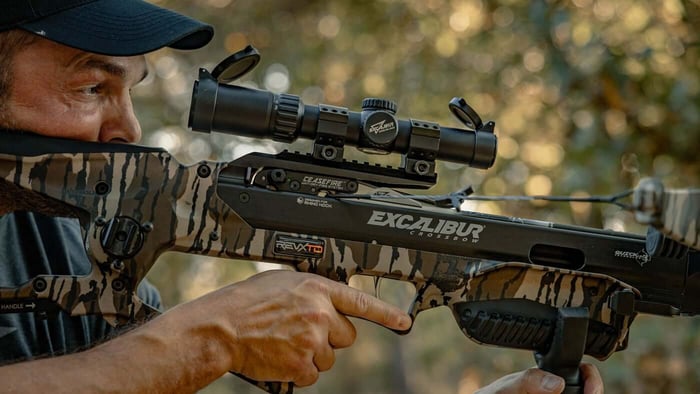

  • Scope and scope battery: It’s always a good idea to verify that your scope rings and bases are tight. Loose rings or bases can cause your scope to shift and severely affect accuracy. If you have an illuminated scope, check to make sure the battery is still functioning and replace if not.

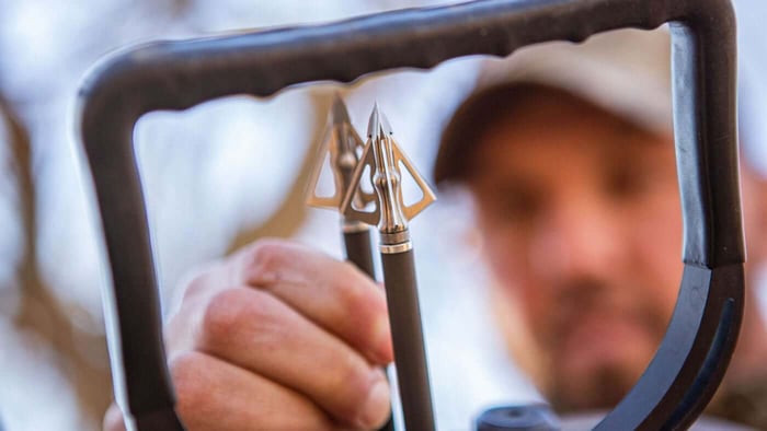

  • Broadheads: Few things ruin a hunt faster than dull broadheads. Check your heads to make sure they are sharp and penetrate well enough to be effective and ethical. If they’re dull or damage, replace them with either a fixed or mechanical broadhead from Excalibur
