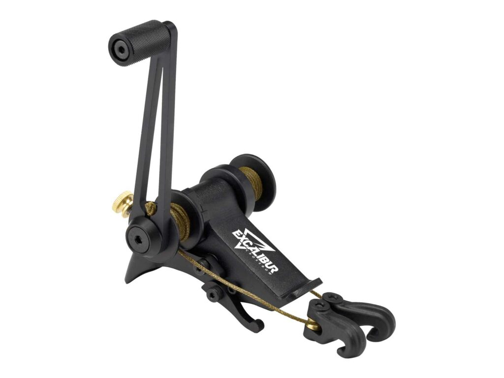

C2 Crank Cocking Aid
Subject Products Description
Product Name: C2 Crank
Model Number: 2199
Distribution Period: 2008 to 2021
Quantity Distributed: Approximately 15,021 units
How-To:
Replace Rope and Hooks
Step 1: Cut and remove old crank rope.
Step 2: Feed the new rope through one side of the spool.
Step 3: Feed the rope through the new hooks.
Step 4: Feed the rope through the opposite spool and tie knot.
Step 5: Engage the catch and turn the crank handle to wind the rope onto the spools .
To Download a PDF of Written Instructions
Click Here
